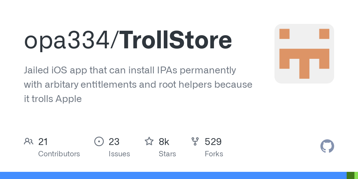

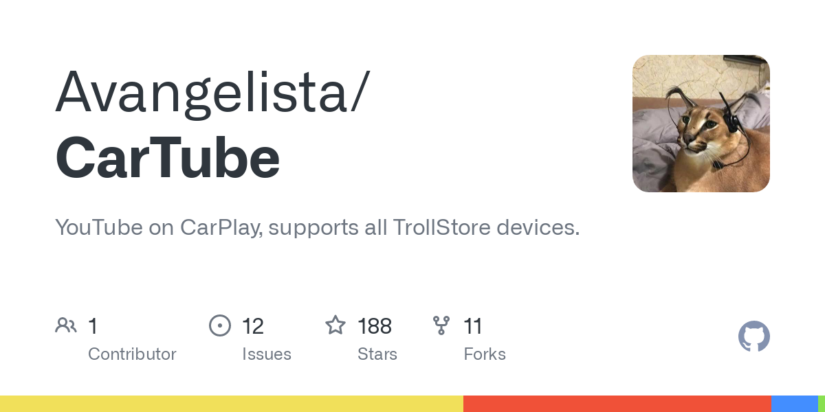

  • Gibt es sonst noch eine möglichkeit evtl. mit apple carplay aber auch das Youtube Videos abspielbar sind?
    Nur mit TrollStore
    GitHub - opa334/TrollStore: Jailed iOS app that can install IPAs permanently with arbitary entitlements and root helpers because it trolls Apple
    Jailed iOS app that can install IPAs permanently with arbitary entitlements and root helpers because it trolls Apple - GitHub - opa334/TrollStore: Jailed iOS…
    github.com
    GitHub - Avangelista/CarTube: YouTube on CarPlay, supports all TrollStore devices.
    YouTube on CarPlay, supports all TrollStore devices. - GitHub - Avangelista/CarTube: YouTube on CarPlay, supports all TrollStore devices.
    github.com
    Bis iOS 15.4.1
