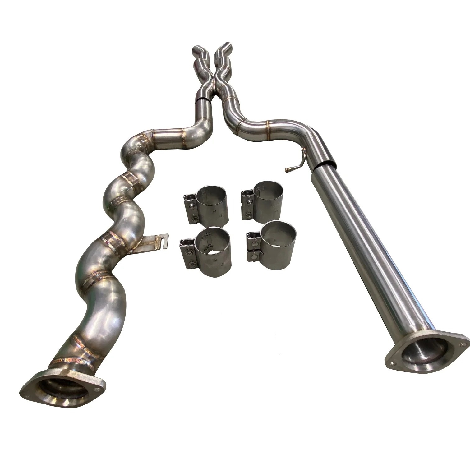

Schau mal hier:
Active Autowerke 2021-2022 BMW M3/M4 (G8X) S58 Signature Equal Length Mid-Pipe w/ G-Brace - German MuscleNOW AVAILABLE FOR PRE-ORDER – shipments are expected to start late March, early April. **This product is a part of the Active Autowerke Motorsport Collection.…germanmuscle.coDas ist der Versuch, equal length herzustellen. Nicht das, auf das Ronny da zeigt...
Zitat
BMW provided an equal length solution with the crossover pipe from the short downpipe. However, they overcompensated and made the length of the drivers side exhaust longer than the passenger side – this equal length midpipe corrects the passenger side exhaust length giving the G80/G82 a true equal length and smoother sound. -
